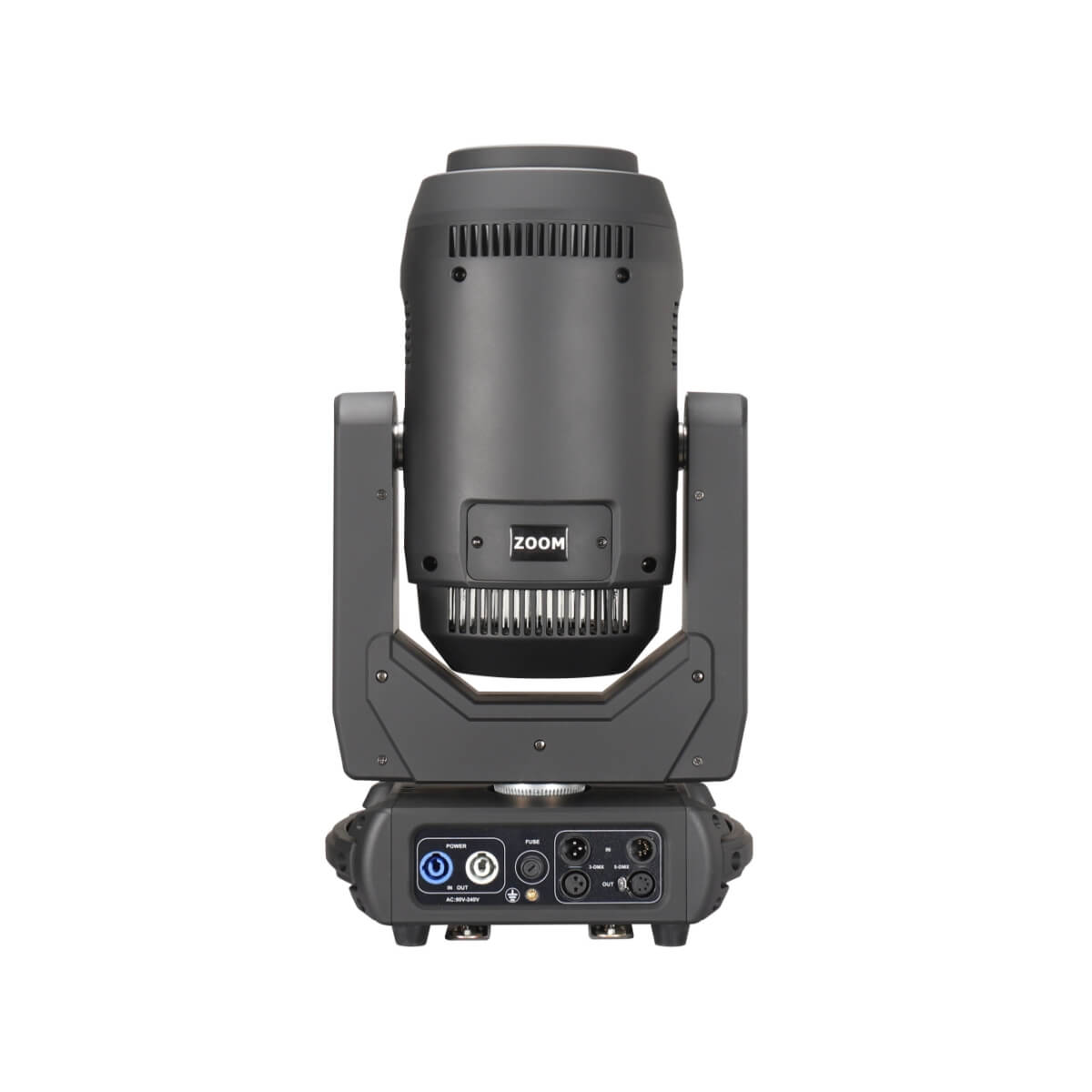

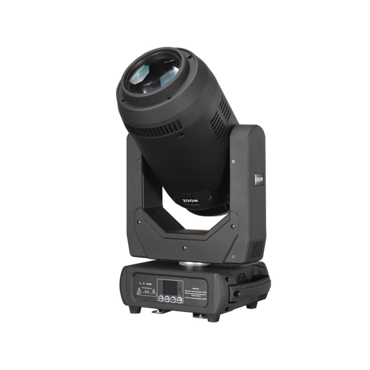

350W Beam Spot Wash Moving Head
Light Technical
| Voltage | 100V~240V AC, 50/60Hz |
| Power | 450W @ 220V |
| Light source | 350W high brightness LED |
| Color temperature | 7500K-8000K |
| Life time | 50000 hours |
| 1 color wheel | 7 colors + white |
| Variable speed bidirectional with rainbow effect | |
| Step/Linear conversion color optional | |
| With CMY function, color can be adjusted; | |
| Can be mixed to make the color richer. | |
| 1 rotating gobo wheel | 7 gobos + white |
| 5-facet prism, can be rotated in both directions | |
| Focus | DMX linear focus adjustment, super smooth focus adjustment. |
| Strobe/Dimming | Electronic strobe, 0.3-25 times/second,linear dimming |
| Atomization | Independent atomized lens, softer light |
| Rotation angle | Use three-phase stepping motor, fast, quiet, with automatic return function. |
| Horizontal | 540° |
| vertical | 270° |
| Beam Angle | 8-35° |
| DMX linear amplification, the beam angle can be freely switched from 8 to 35 degrees | |
| Control mode | DMX512 signal, 3-pin + 5-pin, 20CH channel mode |
| Other functions | Horizontal and vertical speed adjustable |
| Housing material/protection level | High temperature/UV light resistant engineering plastic |
| Protection Grade | IP20 |
| Net weight | 16kg |
| Gross weight | 19kg |
| packing size (mm) | 390(L)*31(W)*710(H) |
| Working temperature | Maximum ambient temperature 50°C |
